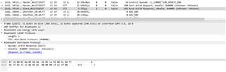

Then, we implemented some changes to the nrf52-ble-app-uart-c-multilink-master example in order to connect to multiple devices with the UUID (0xFFF0).
We were able to do so, however the discovery does not show as been completed as can be seen in the snapshot below and from the response of LED1 we know we are in the connection state:
The nRF BLE sniffer response is shown here:

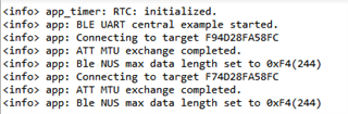

FYI we were able to send write request and receive a response on the connection handle 0x0009 directly by changing the code of the ble_nus_c_string_send() via:
uint32_t ble_nus_c_string_send(ble_nus_c_t * p_ble_nus_c, uint8_t * p_string, uint16_t length)
    VERIFY_PARAM_NOT_NULL(p_ble_nus_c);
    nrf_ble_gq_req_t write_req;
    memset(&write_req, 0, sizeof(nrf_ble_gq_req_t));
    if (length > BLE_NUS_MAX_DATA_LEN)
        NRF_LOG_WARNING("Content too long.");
        return NRF_ERROR_INVALID_PARAM;
    if (p_ble_nus_c->conn_handle == BLE_CONN_HANDLE_INVALID)
        NRF_LOG_WARNING("Connection handle invalid.");
        return NRF_ERROR_INVALID_STATE;
    write_req.type                        = NRF_BLE_GQ_REQ_GATTC_WRITE;
    write_req.error_handler.cb            = gatt_error_handler;
    write_req.error_handler.p_ctx         = p_ble_nus_c;
    write_req.params.gattc_write.handle   = 0x0009;  //p_ble_nus_c->handles.nus_rx_handle;
    write_req.params.gattc_write.len      = length;
    write_req.params.gattc_write.offset   = 0;
    write_req.params.gattc_write.p_value  = p_string;
    write_req.params.gattc_write.write_op = BLE_GATT_OP_WRITE_REQ; //Request instead of cmd as it seemed to be used with nRF connect BLE_GATT_OP_WRITE_CMD;
    write_req.params.gattc_write.flags    = BLE_GATT_EXEC_WRITE_FLAG_PREPARED_WRITE;
    return nrf_ble_gq_item_add(p_ble_nus_c->p_gatt_queue, &write_req, p_ble_nus_c->conn_handle);

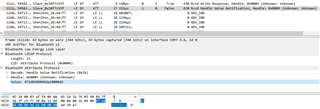

Response nRF BLE sniffer was however not the one we expected:
Via the nRF connect BLE application we received the handle value notification (which was not the case in the above):

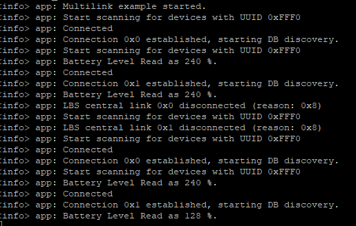

  • Hi Simon,
    In the meanwhile, I adapted the code within the ble_multilink_central example and changed part of the code of the BLE battery service in order to scan and connect based on the UUID 0xFFF0.
    I was able to establish a connection, however still the ble_db_discovery did not return any result.
    Additionally, I was able to receive the battery level read response (which probably is incorrect, but shows that we are able to receive something from the BLE modules).
    A snapshot from my PUTTY window below:

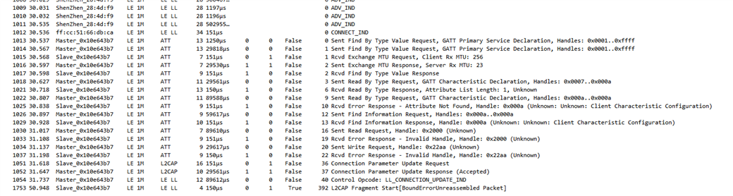

    The nRF sniffer communication of one of the BLE modules you can find here:
