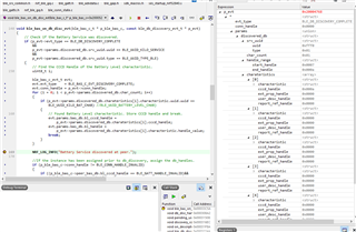

Then, we implemented some changes to the nrf52-ble-app-uart-c-multilink-master example in order to connect to multiple devices with the UUID (0xFFF0).
We were able to do so, however the discovery does not show as been completed as can be seen in the snapshot below and from the response of LED1 we know we are in the connection state:

Hereby, the question arises how to make sure the ble discovery is completed and if this is not possible, how to bypass this step.

  • Hi Simon,
    Thanks for having a discussion with your colleague.
    I have changed the defines as you said in the function ble_bas_on_db_disc_evt() with BLE_UUID_KILO_SERVICE = 0xFFF0  and BLE_UUID_KILO_BAT_CHAR = 0xFFF1. During debugging, I do get the output that the battery service was discovered at the peer. However, only 1 battery characteristic (0x000a) has been found as depicted in the below screenshot.
    In my opinion this is incomplete as above nRF sniffer outputs showed with nRF Connect that multiple attribute connection handles were found. How can I make sure all characteristics are discovered?
    For your information, the complete subscribe address UUID for the battery information is 0000fff1-0000-1000-8000-00805f9b34fb.
    Regarding BLE SIG UUID, thanks for mentioning, however we are aware of this and this won't be a commercial product.
    Regarding blcm_link_ctx_get() in the SDK, could you guide me in which file this function is defined? Where should I call this function? Is there any example that makes use of this?
    Tom
  • Hi
    It should keep discovereing characteristics based on what the char_count is set to in the for loop which should be equal to the number of characteristics present in the service.
    The blcm_link_ctx_get() function is defined in the ble_link_ctx_manager.c/.h files, and is used by I.E. the ble_app_uart example in the ble_nus.c file.
    Simon
  • HI Simon,
    We see in the debug output that the char_count only goes to 0x01. Is this normal as we see multiple characteristic in the nRF sniffer log when using the nRF Connect application.
    Tom
