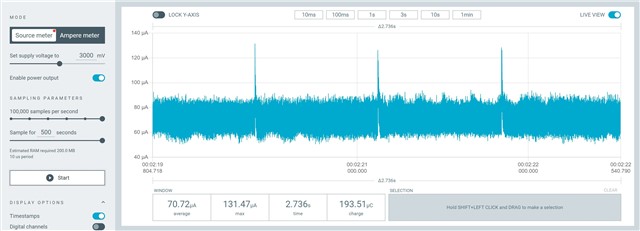

I was testing our custom FW on a nRF9160 DK and I noticed a high PSM power consumption. The DK was consuming around 70µA while our custom board consumes ~15µA.
I then got 1452.sysoff.hex file from this guide to check if everything is right and I noticed it is consuming around 70µA even in system off mode (~5µA on custom board):
Do you have any idea what could be causing this? I am supplying power with PPK2 source mode through the VDD_nRF-pin (P22) like shown here. I have made sure the board controller FW is the original one provided here. I have no USB cable or anything else attached to the DK. I have also tried removing the SIM-card and disconnecting the interface MCU by moving the IFMCU DISCONN-switch to the right position. Neither of these helped with the consumption.
As far as I know the current should only be going to nRF9160 when supplied through the VDD_nRF-pin and therefore only be a few microamps in both cases. Is there anything I need to change/check in addition to the things I have already done? Or is my DK faulty?
