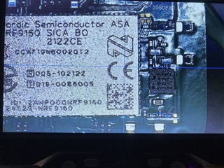

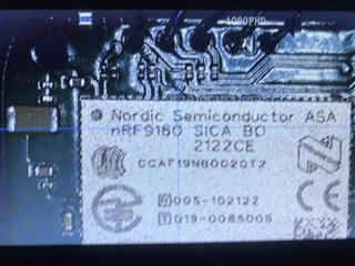

Chip unresponsive voltage at DEC0 is 0.04v
Chip nrf9160 SICA B0

Q1: How many boards has this problem, and how many has been produced?
Q2: Has the board been reworked (warmed up again) to see if the behavior changes then?

I solved the problem. It is necessary to poolup nReset output to plus voltage. I understand this problem only in revision B0
A pull-up on the nRESET pin is not necessary, as there is one internally in the nRF. Could you check the voltage on the ENABLE pin to see if this is set high?

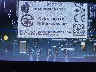

nRESET pin - 0.07 V
ENABLE contact - 3.26v I filed with nrf52840

Q1: There were 3 boards made, there is a problem on all 3 boards
Q2: No. There on the bottom side nrf52840 so we did not warm up
Given that pulling the nRESET pin high makes the nRF9160 run, it can indicate a short or something pulling the pin low.
Have you checked the current consumption of the nRF? When both pulling nRESET to VDD, and when leaving the pin unconnected.
What is the VDD provided to the nRF9160?
