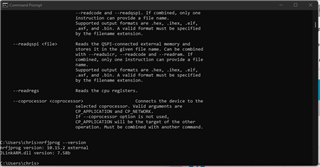

This may be caused by either J-Link or nrfjprog. In both cases the reinstallation might help.
Could you please update nRF-Command-Line-Tools to the latest version 10.15.2?

Hi Dejan,
I've reinstalled per your suggestion and update the command line tool to 10.15.2. This issue is still there.

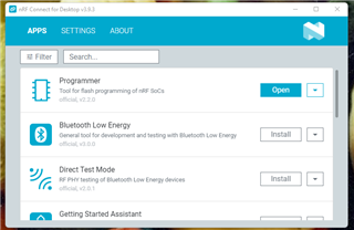

I've provided screenshots

Hi Chris,
I updated nRF Connect for Desktop to the newest version 3.9.3 and the Programmer to the version 2.2.0, but I cannot see the problem that you described.
Check first your board's connection to the PC. In Windows 10 you could check if the board appears as connected to the COM port using Device Manager. Additionally, verify that the board is listed in the output of the command "nrfjprog --com".
