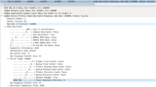

    From the sniffer trace, it looks like the Conbee II reports as a legacy device (i.e. not a Zigbee 3.0 device/Zigbee specification above r21).
    The End device timeout protocol was first added to the specification in r21, so this may not be supported by the coordinator. I'm not sure what happens in your sniffer trace, but it looks like the device sends a new "Permit Join Request" in frame 126, then stops sending more packets after this.
    Can you try to add zb_bdb_set_legacy_device_support(1); to the Multisensor example, and capture a new sniffer trace to see if this makes any difference?
    Jørgen
    chris.t said:
    Where from the trace can you determine that the Conbee is reporting as a legacy device?
    This can be seen from the "Stack Compliance Revision" flag in the Coordinators "Node descriptor response":
    According to the R21/R22 specifications, this field should be set to the spec revision (21/22). On legacy devices (pre-r21), the field is reserved and set to 0's.
