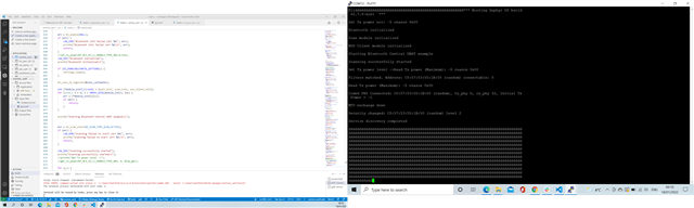

How to print RSSI value of all the advertising packets from peripheral to central and print on PuTTy.
I'm working on central_uart and peripheral_uart examples. I want to get the rssi value and tx_power of all advertising packets from peripheral to central via bluetooth connection. How can i get these values and print the same on the PuTTy terminal.
Can you please guide me with all the functions i need to involve in the peripheral or central main functions.
Regards
Karthik Kumar

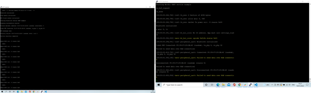

    I have made these modification on the peripheral uart file which are in red coloured text.

    Reading RSSI Value
    static void read_conn_rssi(uint16_t handle, int8_t *rssi)
        struct net_buf *buf, *rsp = NULL;
        struct bt_hci_cp_read_rssi *cp;
        struct bt_hci_rp_read_rssi *rp;
        int err;
        buf = bt_hci_cmd_create(BT_HCI_OP_READ_RSSI, sizeof(*cp));
        if (!buf) {
            printk("Unable to allocate command buffer\n");
            return;
        cp = net_buf_add(buf, sizeof(*cp));
        cp->handle = sys_cpu_to_le16(handle);
        err = bt_hci_cmd_send_sync(BT_HCI_OP_READ_RSSI, buf, &rsp);
        if (err) {
            uint8_t reason = rsp ?
                ((struct bt_hci_rp_read_rssi *)rsp->data)->status : 0;
            printk("Read RSSI err: %d reason 0x%02x\n", err, reason);
            return;
        rp = (void *)rsp->data;
        *rssi = rp->rssi;
        net_buf_unref(rsp);
    //uint32_t sd_ble_gap_rssi_start    ( conn_handle, BLE_GAP_EVT_RSSI_CHANGED, BLE_GAP_EVT_RSSI_CHANGED);

    static void connected(struct bt_conn *conn, uint8_t conn_err)
        int err;
        int8_t txp;
        struct bt_conn_info info;
        if (conn_err) {
            LOG_ERR("Connection failed (err %u)", conn_err);
            printk("Connection failed (err %u)\n", conn_err);
            return;
        /*bt_addr_le_to_str(bt_conn_foreach(conn), addr, sizeof(addr));*/
            err = bt_conn_get_info(conn, &info);
        if (err) {
            printk("Failed to get connection info\n");
         else {
            const struct bt_conn_le_phy_info *phy_info;
            phy_info = BT_CONN_LE_PHY_OPT_CODED_S8;
            get_tx_power(BT_HCI_VS_LL_HANDLE_TYPE_CONN,
                         NULL, &txp);
            LOG_INF("Connected: %s, tx_phy %u, rx_phy %u ,Initial Tx Power = %d",
                   log_strdup(addr), phy_info->tx_phy, phy_info->rx_phy, txp);
            printk("Coded PHY Connected: %s, tx_phy %u, rx_phy %u, Initial Tx Power = %d\n",
                   //printk(NRF_RADIO->RSSISAMPLE);
                   //uint32_t sd_ble_gap_rssi_start ( conn_handle, 0, 0)
        current_conn = bt_conn_ref(conn);
        /*current_conn = bt_conn_foreach(conn);*/
        dk_set_led_on(CON_STATUS_LED);

  • Hi Einarh,
    Towards left is the central_uart putty terminal and right is peripheral_uart putty terminal.
    from the https://developer.nordicsemi.com/nRF_Connect_SDK/doc/latest/zephyr/samples/bluetooth/hci_pwr_ctrl/README.html example, made use of below 2 function for RSSI and TX_Power
    static void set_tx_power(uint8_t handle_type, uint16_t handle, int8_t tx_pwr_lvl).
    but as seen on the terminal its prompting and error as follows,
    d Read RSSI err: -5 reason 0x00 // for read rssi.
    Set Tx power err: -5 reason 0x00 // for Tx_power.
    How can this errors be resolved and get the actual rssi and tx power values. Also wanted to time stamp each packet. How can that be done?
    Peripheral_uart modified code

  • ok, we're getting somewhere.
    The error code you're getting seems to mean that there is "no buffer space available".
    I'm trying to look through your code to see how you are using the rssi function, but there is a lot of code so it's not easy for me to see precisely what you are doing.
    Can you tell me exactly what input arguments you are giving to the rssi function?
    It is also still not really clear to me how your application is intended to function. Do you wish to measure rssi on the peripheral or central side?
    There are many ways you could make a timestamp, I would probably use Zephyr's Counter API.
    Einar
  • Hi Einarh,
    I'm calling the rssi function in,
    static uint8_t ble_data_received(struct bt_nus_client *nus, const uint8_t *data, uint16_t len)
    function.
    	ARG_UNUSED(nus);
    	int err;
    	int8_t txp = 3;
    	int8_t rssi = 0xFF;
    	for (uint16_t pos = 0; pos != len;) {
    		struct uart_data_t *tx = k_malloc(sizeof(*tx));
    		if (!tx) {
    			LOG_WRN("Not able to allocate UART send data buffer");
    			printk("Not able to allocate UART send data buffer\n");
    			return BT_GATT_ITER_CONTINUE;
    		/* Keep the last byte of TX buffer for potential LF char. */
    		size_t tx_data_size = sizeof(tx->data) - 1;
    		if ((len - pos) > tx_data_size) {
    			tx->len = tx_data_size;
    		} else {
    			tx->len = (len - pos);
    		memcpy(tx->data, &data[pos], tx->len);
    		pos += tx->len;
    		/* Append the LF character when the CR character triggered
    		 * transmission from the peer.
    		if ((pos == len) && (data[len - 1] == '\r')) {
    			tx->data[tx->len] = '\n';
    			tx->len++;
    		/* modifications*/
    		printk("\n");
            typedef uint32_t(* nrf_log_timestamp_func_t)(void);
    		err = uart_tx(uart, tx->data, tx->len, SYS_FOREVER_MS);
    		//set_tx_power(BT_HCI_VS_LL_HANDLE_TYPE_ADV,0,txp);
    		//printk("   TX_Power: ",txp);
    		read_conn_rssi(tx->data, rssi);
    		printk("   RSSI: ",tx->data);
    		if (err) {
    			k_fifo_put(&fifo_uart_tx_data, tx);
    I want to measure both RSSI and TX_Power at the central end. Also set the TX_Power at peripheral side alone.
    In terms of Zephyr's Counter API. which would be the better function to select.
    regards
    karthik kumar
