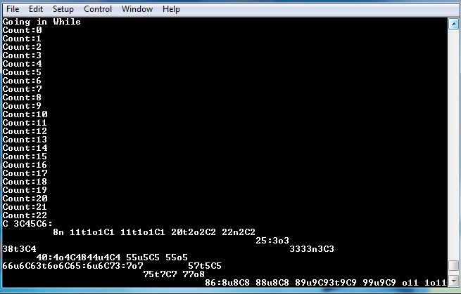

Hi, Here is the piece of code that is bugging me. The code algo is at every 500ms timer2 interrupts, and the adc captures 1500 samples and stores it in an array .I always have to stop the timer2 for printing and calculations and then start when it is done. Here newsamples is array; datatype is float and "ts" is integer defined as 1500 and IDE used is KEIL uVision 5.0.
KINDLY VERIFY WHAT IS THE PROBLEM AND HAVE I ENABLED/DISABLED TIMER2 INTERRUPTS CORRECTLY?

It does not print all the newsamples values and instead prints garbage after 15th value and doesnt show the statement "Going out of while". Here is the output while1.png
But when I don't print newsamples it shows both the statements.

  • @Hung Bui: Thanks for correcting me. I tried the above mentioned suggestions, but same garbage values are occuring after certain values. Now what I did is stopped the adc interrupt and closed the adc part. Now I am only printing values of var j after running timer2 only once to check if their is a problem of interrupt or not. But after printing j value till count 22 the same garbage is occuring as u can see in the screenshot provided. screen1.png
  • How do you declare the array newsamples ? Note that float is 4 bytes, if you define it with the size 1500 elements it will be 6kB which maybe over the size of RAM available for the 16kB RAM mRF51 variant. You can try to reduce the size of the array to 50 for testing, for example.
  • @Hung Bui: I have only printed the "j" values which is defined as an integer and increments till 1500. I have disabled the ADC part to check why the garbage values are occuring and I am not reading any values just free processing the controller. If u look at the screenshot it is still providing the garbage values after printing certain "j" values. I'll also test your mentioned suggestion about memory part,as the product specification says "Each block is divided into two 4 kByte RAM sections with separate RAM AHB slaves." so if I fill the array almost 4kB it won't be a problem.
