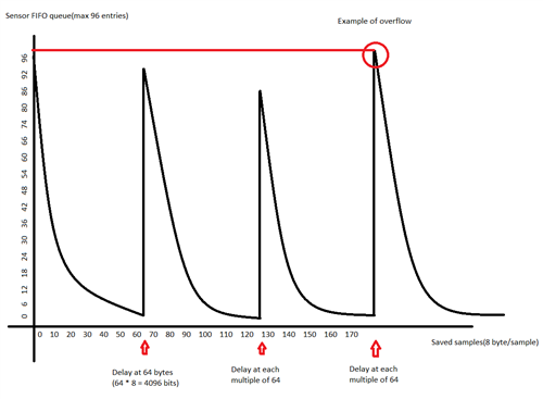

I'm reading sensor data on the nrf9160DK, the sensors have a fifo with 96 entries. If I can't read the sensors fast enough, the fifo overflows and I get data loss.
The sampling rate is 4000 SPS and the sample size is 64bit. Therefore, there is not enough RAM to hold data and there is a need of continuously writing data to memory.
Now, I have integrated a micro sd card, it writes fast, faster than the external flash. If I do a measurement of 20 seconds, sometimes there is no fifo overflow but sometimes there are 2-3 entries being lost during the recording. I find it interesting that it is inconsistent.
However, it is extremely close to being fast enough, and sometimes it actually is. Now, as for solutions I've been considering multi-threading.
The write speed is fast enough and the fifo queue is decreased to its lowest value but then we reach entry #64, there is a delay. I'm guessing this has to do with the cluster or page size of the FAT32 format and the allocation of new memory units takes a bit of time. Every multiple of 64 there is a delay. Each entry is 64 bits so it's every 4096 bits this occurs.
Sometimes this resizing makes the queue overflow but not always. Sometimes it goes from 0 to 40 entries in the fifo, which is fine, other times it goes from 0 to 96 and we have data loss. I thought that maybe you could multithread this so that during the write, we still take down data from the fifo and store it in a variable until the write function is done, thus ensuring there is no data loss. Would this be possible? If so, how is it implemented in code?
I've been using fs_write when writing to a file on the sd card.

  • nWre said:
    there is a delay using fs_write
    Is the delay caused by the call to fs_write(), or do you call fs_write all the time, and every 64 samples fs_write() takes longer than usual?
  • I call fs_write all the time, and every 64 samples fs_write() takes longer than usual. That is why I'm thinking of allocation of new memory space. I'm using a 32gb sd-card because that is what I had on hand but a 2gb would do just fine. I ordered one (hard to find a 2gb sd-card in modern times haha) to see if maybe that speeds things up a bit.

  • The only way it detects the SD-card is if it is formatted with the official sd-cart-formatter. Windows wont do. In that formatter you can't set your preferred cluster size but it detects the size of the sd-card and sets cluster size according to that. My card has a cluster size of 32kB and not 512 bytes(64 entries * 8 bytes per entry = 512 bytes). If I can't work around this, is it possible to write code such that when the writing operation is busy, I simultaneously read the sensor and store it in a variable until the fs_write function is done and then write that data to the card?
    Thanks Edvin, I really appreciate your help!
    Sorry for the late reply. Yes, you can use one thread to read and one thread to write. I am not familiar with the nRF91, but look at how the NCS\nrf\samples\bluetooth\peripheral_uart uses one thread to read UART and another to send UART data over Bluetooth LE.
