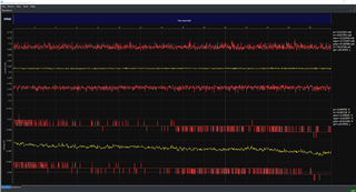

The main idea for our prototype board is a datalogger, that sends data periodically over LTE networks using MQTT, so low power is an absolute must. I noticed when using our current code we  see constant currents of around 3mA at its lowest, even when its in Power Saving Mode (PSM). So I looked into this a bit more thoroughly.
I saw this question posted below, and tried to recreate his code, following an example through a link he posted. I also tried multiple different things with the GPIO configuration - ended up making them all high-z.
https://devzone.nordicsemi.com/f/nordic-q-a/63745/lowering-the-power-consumption-of-nrf9160-mqtt_simple-ncs-1-3-0
Even when running this code, I was seeing about 2.7mA constant current. So around 500x more than expected.

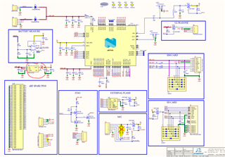

Ok, so now I thought I must've messed up something on the design, so I take off the 3V regulator circled in the schematic, and removed the pullup resistors on the SDA/SCL lines, so  the only thing being powered is the nRF9160. I now get 2.61mA
Is there something fundamentally wrong with my schematic to get into a low power idle state? Could the reserved pins underneath the package cause a high constant current if shorted together somewhere? Is the code missing anything to be in low power?
Schematic and code below

    For some reason I thought it would automatically be off, and in the process of testing this I actually found what was going on. I always suspect there is loss through the JLink debugger so I always unplug it after I have flashed the board. This time, when I removed VRef the current went down to ~500uA, when I removed the reset line, it jumped up to 3mA again.
    Seems like the JLink pulls down reset but it goes high when removed from the JLink. Looking at the schematic I can see why, and looking at datasheet, I can see that nReset shouldnt be pulled higher than 2.2V.

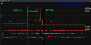

    Now I expected if I reset the board, and put a jumper across RESET and GND, then this would mean I should see ~500uA after startup, but thats not what happened.
    As you can see in the image below, I got just over 1mA initially, but if I took the jumper off and replaced it again it did go down to 434uA. This seems odd behaviour to me, and can't really understand why that happening. Is there a resource that shows how the nReset line should be connected up? I just copied the nRF9160DK schematic for the reset stuff, with a slight change in what FETs are used as they were ones we use elsewhere already, but I cant see why they would cause much issue, and they seem to be doing exactly what I expect.

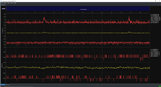

    Looks like I found out where the 96uA was coming from. On the battery measuring circuit it looks like I was actually enabling the LMV341. I added -
    nrf_gpio_cfg_input(21, NRF_GPIO_PIN_PULLDOWN);
    at the start and I observe 4uA constant current.
    I have just tried out the UDP sample, and when its in Low power state, I see ~40uA constant current.
