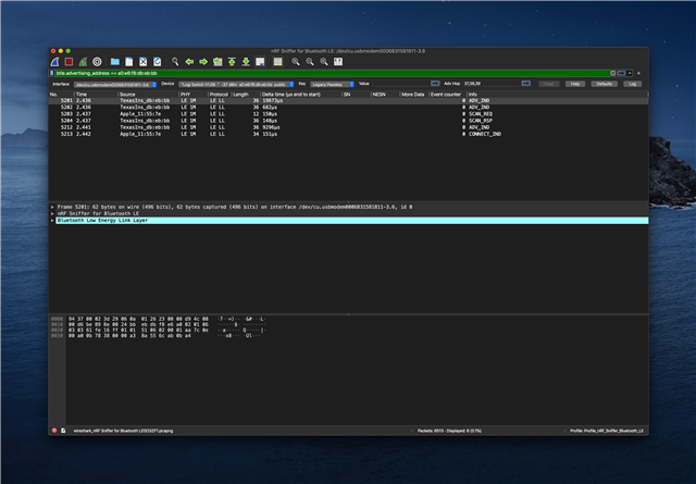

What can I do to see all the packets going between the the button and the central?
only_adv.pcapng
    Normally, this means that you have not selected the device to listen for in the dropdown menu. When this is set to 'all advertising devices' the sniffer will not follow into any connections, but instead only listen for packets on the primary advertising channels. It does however seem like you have selected the device, so that should not be the issue here.
    Could you verify that the devices actually went into a connection while your sniffer was listening, and could you also ensure that you are listening to the correct device?
    Did the advertising packets keep on coming in even after the devices entered into the connection? If so, is this the correct behavior of the peripheral device, or could it be that you are targeting an incorrect device?
    In the attached sniffer trace it seems that you have not applied any filter / chosen a specific device to follow, but your screenshot seems to have all the correct filters set.
    For the record, you do not have to fill in the btle.advertising_address filter in the top bar if you make use of the key and value fields to follow your device. The filter specified in the top bar only filters what is viewable in the sniffer trace, as a convenience. You could try to remove this line, to see if this changes anything in your trace.

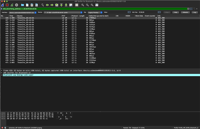

  • Hey Karl, thanks for your answer!
    Yeah I'm positive that the device went into a connection while the sniffer was listening. The central is actually a node.js script on the mac - I'm able to follow the connection through it. I've also tried with the connection being made from my iPad - got the same issue. I've also double-checked the device id, I'm 100% sure it's the right device id.
    Once the connection is made, the advertising packets are not received. The button automatically disconnects after about 10sec. Once I wake up the button again, the advertising packets are coming back as expected.
    I was using `btle.advertising_address.filer` in the toolbar because selecting the device in the dropdown didn't filter anything.
    How should I use Key/Value to follow the device? Any other advise here?
    Selecting the device in the dropdown did not filter anything? That is very strange.
    The key and value field can be used for different things, like following a LE Address without having seen it first (it only appears in the device drop down list after an advertising is picked up from it), or to follow privacy enabled devices through use of the IRK directly (the identity key, used for generating the new addresses), for instance.
    You can do this by selecting the desired key - such as Follow LE Address - and then inputting the value - the LE Address in this case - in the value field, and pressing the arrow button on the value field to apply it.

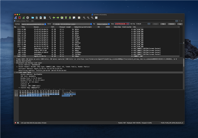

    I am not sure I understand how that works. When I input an address in the "Value", the field gets all red and I cannot click on the arrow (see screenshot)
    This is strange indeed. Are the devices already paired/bonded, so that they could be reverting to their stored keys once the connection indication is received?
    To be honest, I don't know. It seems that anything can connect to this button.
    If not, could you show me the contents of the CONNECT_IND packet?
    Please find attached the trace with CONNECT_IND
    connect_ind.pcapng
    Thank you for your patience with this.
    You will need to include the " (random)" or " (private)" at the end of address before it is a valid address.
