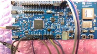

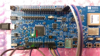

    I have attached two photos which show the working setup (scenario 1, supply via USB) and the not working setup (scenario 2, supply via P21). These setup only differ with respect to the power supply in use.

    I use both, a Pin labeled VDD (green arrow in the scenario 1 picture) and a Pin labeled 5 V (red arrow in the scenario 1 picture) to supply the periphery attached to the board. The pin labeled VDD behaves as expected in both scenarios. It provides a power of 3 V. However, the pin labeled 5 V only provides a power of 5 V if the board is supplied via USB. If the board is supplied via P21, the pin labeled 5 V provides a power of 0 V.

    Scenario 1, everything works, supply via USB:
    Scenario 2, not working, supply via P21:
    The "5V" pin is the VBUS line, so this will only be provided when powering the board through USB.
    The input voltage to the nRF is provided through the "VDD nRF" pin on pin header P20.
    Note that "VDD" is 1.8V or 3V depending on the position of the "VDD_IO" switch.
    Håkon
    Ok. That is good to know. That means, that I have to change my setup to compensate for this.

    It turned out, that my sole problem was, that my periphery wasn't supplied anymore by the board's "5 V Pin" when supplying the board via P21. Since you explained to me, that this is the expected behavior of the nrf9160 DK, I consider this case closed.
