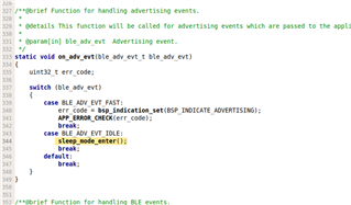

    Do you see the same if you comment the call to sleep_mode_enter() here:
    It's here the example tries to enter system OFF mode (deep sleep) after advertising has timed out after 3 minutes of inactivity. It's however not possible to enter System OFF mode while the chip is in debug mode, so this will lead to an assertion and cause the program to reset in the default error handler.

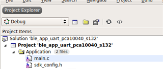

    Note that you can use the "Debug" build configuration to get more error information from the fault handler (crashlog is printed out on RTT):

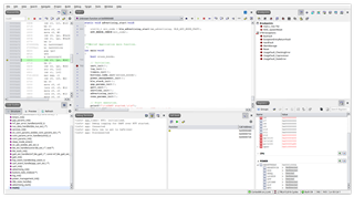

    I was using Debug configuration, but I can't see any crashlog printo into RTT, it just looks like this (can't see any information like Ozone would show about fault handler, any idea why?):
    SES upon reset
    EDIT:
    Here is how it looks like when I use Debug configuration and also enable debug messages via RTT, still no crashlog:
