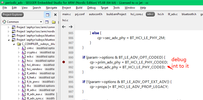

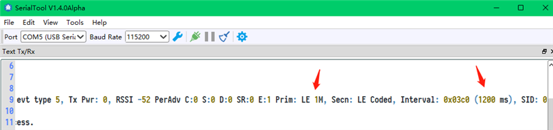

how to enable LE_CODED in NCS1.8.0 periodic_adv ?
NCS1.8.0 Windows10 X64,
periodic_adv had set BT_LE_ADV_OPT_CODED   and   BT_GAP_ADV_FAST_INT_MIN_2 /* 100 ms   */
periodic_sync scan info "Prim: LE 1M, Secn: LE Coded, Interval: 0x03c0 (1200 ms)"
question:
1. why it still  Prim: LE 1M?
2. why the Interval is 1200ms?
thanks

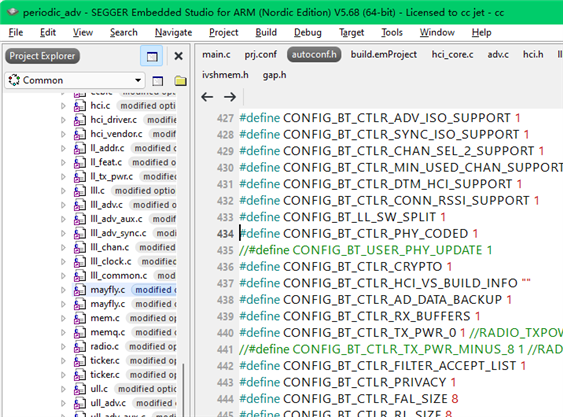

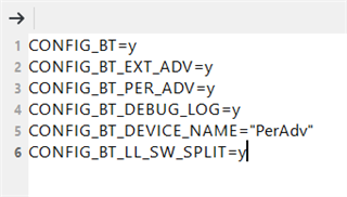

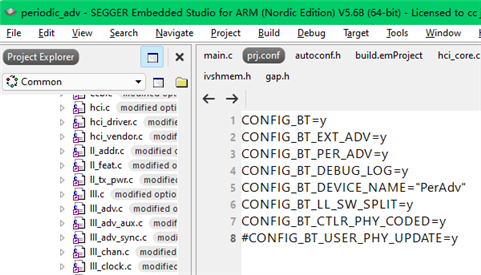

  • Hi
    You also need to add the CONFIG_BT_CTLR_PHY_CODED=y to add Coded PHY support in prj.conf. You can also add CONFIG_BT_USER_PHY_UPDATE=y here although I don't think it's necessary.
    Simon
  • Hi is the following function missing bt_le_ext_adv_set_data
    i add bt_le_ext_adv_set_data at line 74,
    but the periodic_sync  log show the same;
    periodic_adv source code and serial log,

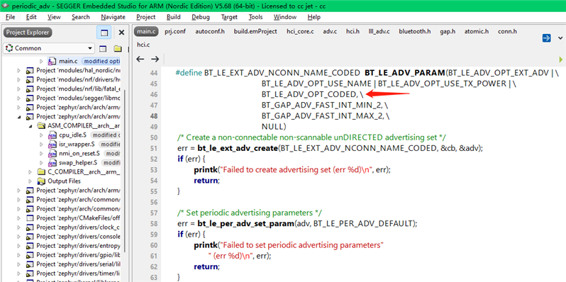

            /** Non-connectable extended advertising with @ref BT_LE_ADV_OPT_USE_NAME BT_LE_ADV_OPT_CODED */
           #define BT_LE_EXT_ADV_NCONN_NAME_CODED  BT_LE_ADV_PARAM(BT_LE_ADV_OPT_EXT_ADV | \
    						 BT_LE_ADV_OPT_USE_NAME | BT_LE_ADV_OPT_USE_TX_POWER | \
                                                     BT_LE_ADV_OPT_CODED, \
    						 BT_GAP_ADV_FAST_INT_MIN_1, \
    						 BT_GAP_ADV_FAST_INT_MAX_1, \
    						 NULL)   //Peer address, set to NULL for undirected advertising
    	/* Create a non-connectable non-scannable unDIRECTED advertising set */
    	err = bt_le_ext_adv_create(BT_LE_EXT_ADV_NCONN_NAME_CODED, &cb, &adv);

    periodic_sync  serial log
    [DEVICE]: 0D:7E:90:95:48:AB (random), AD evt type 5, Tx Pwr: 0, RSSI -25 PerAdv C:0 S:0 D:0 SR:0 E:1 Prim: LE 1M, Secn: LE Coded, Interval: 0x03c0 (1200 ms), SID: 0
    Found periodic advertising.
    Creating Periodic Advertising Sync...success.
    Waiting for periodic sync...
    PER_ADV_SYNC[0]: [DEVICE]: 0D:7E:90:95:48:AB (random) synced, Interval 0x03c0 (1200 ms), PHY LE Coded

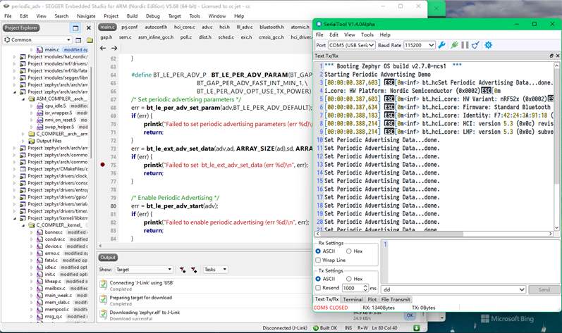

    yuyou
  • Check the error status when using bt_le_ext_adv_set_data
  • The reason I'm asking is that I have an error which I didn't have prior to SDK V1.8 which causes the advert to fail.
    thanks for reply,
    i've add check the err code ,but not getting error, it's running.
    yuyou
