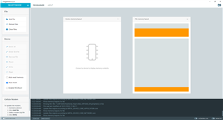

I encounter a problem when trying to write the hex files for the Heart Rate Monitor demo to the board using the nRF Connect Programmer. The programmer does detect the board as the nRF5340-DK in the board selector, but the is labeled as 'unknown' in the device memory layout section. Also, all operations that can be performed on the device (erase all, write, read etc.) are greyed out (see attached screenshot).

    It is possible that readback protection is enabled. Please try to recover the device to disable the readback protection. You can do so by entering the following commands in a terminal:
    nrfjprog --recover --coprocessor CP_NETWORK
    nrfjprog --recover
    Make sure that you order you enter the commands are as above, as you must recover the network core before the application core.

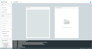

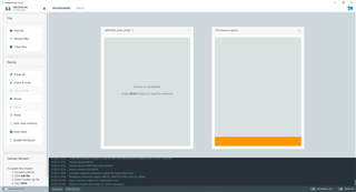

  • Thank you for your help. I am now indeed able to read the application memory and write to the application memory. I am still unable to write the hci_open_amp.hex file to the device (from the heart rate monitor demo), which is meant for the network core. It does not show up in the 'File memory layout' window. When the board is disconnected, I am able to add it to the File memory layout window (See images).
    I checked with the developers, and this seems to be a bug in the current version of nRF Connect for Desktop. They are currently working on fixing this, but I do not have a time frame for when this will be fixed.
    In the meantime you can program the samples using command line by following the steps explained here: Using the command line.
    Another option is to downgrade nRF Connect for Desktop to v3.7 and use that until this is fixed. Follow these instructions to use the older version:
