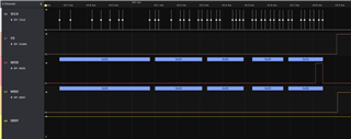

For a project I am currently trying to do a simple test to check the SPI communication between the nrf5340 en ADS1299(ADC for EEG application) before we order our pcbs.
So far I haven't been able to get it to work, to narrow down the source of the problem I connected a logic analyzer and the signals look different than I would expect (see the following pictures).
As can be seen the clock signal doesn't have a constant frequency and the duty cycle of the clock signal is not ~50% as I would expect.

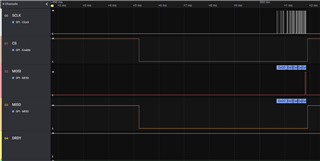

To test the MOSI signal I tried sending another command (at first all commands had just one bit which was a 1), I tried sending 0b10101010 which resulted in the following picture.
On the positive side the command send is present in the MOSI signal, however the different periods of the bits don't seem correct.
Given these results I expect there might be something wrong in the way I handle the SPIM on the nrf5340, does anyone have any idea what the problem might be?
