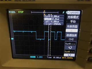

  • thank you very much. I get the waves like this:
    the slot is 2us.
    BUT, waves may disappear sometimes, then I reboot aoa rx board, the oscilloscope  can get the waves, the aoa rx sample may have a bug?
    thanks.
