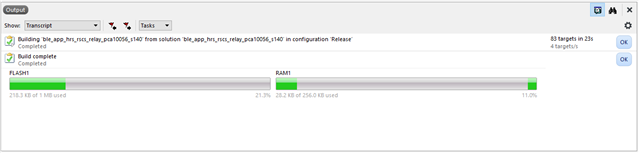

  • I compiled the relay example that support both central and peripheral role, the flash and ram usage include the usage by the softdevice BLE stack and relay application. There is very much RAM available if you are planning to use the nRF52840:
