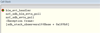

And, call stack window is as below in IAR. It looks like observer issue?
How to avoid disconnection in these android phone?

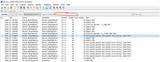

    Can you please try to capture a sniffer trace of one of the connections that disconnect? You can use the nRF Sniffer for Bluetooth LE for this.
    Please upload the sniffer trace as a .pcapng here.

    Please check attachments. I'm not familiar with sniffer. If there are wrong data, please tell me.

    Thank you for the detailed video and the new sniffer trace.
    From the trace, I can't see anything that would indicate that they are bonding twice, so it could be the phone acting weird (that would not be the first time).
    It is the nRF that decides to disconnect in packet number. 2344 in the sniffer trace (ble_cts_c_sniffer_filter_nordic_video1.pcapng). I see that you have some screenshot from the callstack in your original post. What does it point to? Is that just the disconnected event?
    The softdevice will never initiate a disconnection itself with the reason Remote User Terminated Connection (0x13). So it has to be done from the application somewhere. Can you please try to set a breakpoint at all the calls to sd_ble_gap_disconnect() and see if any of them are reached when the devices disconnect?

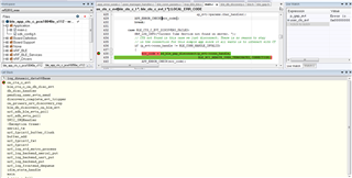

    In previous call stack information, I set break point at all case of BLE_GAP_EVT_DISCONNECTED.
    In setting breakpoint at all sd_ble_gap_disconnect(),  I use pca10040e s112 example code, except no used function in pm_hanlder_disconnect_on_sec_failure and pm_handler_disconnect_on_insufficient_sec . It's triggered at BLE_CTS_C_DISCONVERY_FAILED of on_cts_c_evt. That means the phone don't have this service?

  • I see. Then I guess it is the line 430 in main.c that was triggered then:
            case BLE_CTS_C_EVT_DISCOVERY_FAILED:
                NRF_LOG_INFO("Current Time Service not found on server. ");
                // CTS not found in this case we just disconnect. There is no reason to stay
                // in the connection for this simple app since it all wants is to interact with CT
                if (p_evt->conn_handle != BLE_CONN_HANDLE_INVALID)
                    err_code = sd_ble_gap_disconnect(p_evt->conn_handle,
    This is a special case in Bluetooth Low Energy, because usually it is the peripheral that holds the services and the central is the client, but in this case it is the central that "owns" the service, and the peripheral is the client. If the phone doesn't provide the Current Time Service, then this application will disconnect in the above snippet. However, the behavior of the application is completely up to you. If you still want to connect to the phone and use other services, then you are perfectly fine to so so.
