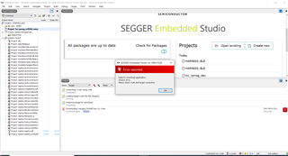

we have developed our custom board using nrf5340. We are using NCS v1.7.1 for application development. I can't able to flash the HCI_rpmsg application to the network core of the Nrf5340 dk as well as the custom board. While I am trying I have received the below error
Kindly, help me to resolve this

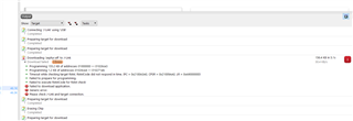

  • Hi Rory,
    I have already followed those methods. These methods triggers the  below error
    Thanks & Regards
    Navin

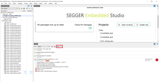

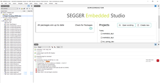

  • Yes, Prianka,
      The below file has that message which I have got
    AP[1]: Core found
    AP[1]: AHB-AP ROM base: 0xE00FE000
    CPUID register: 0x410FD214. Implementer code: 0x41 (ARM)
    Found Cortex-M33 r0p4, Little endian.
    FPUnit: 8 code (BP) slots and 0 literal slots
    Security extension: not implemented
    CoreSight components:
    ROMTbl[0] @ E00FE000
    ROMTbl[0][0]: E00FF000, CID: B105100D, PID: 000BB4C9 ROM Table
    ROMTbl[1] @ E00FF000
    ROMTbl[1][0]: E000E000, CID: B105900D, PID: 000BBD21 Cortex-M33
    ROMTbl[1][1]: E0001000, CID: B105900D, PID: 000BBD21 DWT
    ROMTbl[1][2]: E0002000, CID: B105900D, PID: 000BBD21 FPB
    ROMTbl[1][6]: E0042000, CID: B105900D, PID: 000BBD21 CSS600-CTI
    Loading target script file nRF_Target.js
    Preparing target for download
    Executing Reset script Reset();
    ResetTarget() start
    ResetTarget() end
    Downloading ‘merged_CPUNET.hex’ to J-Link
    Programming 156.5 KB of addresses 01000000 — 01027217
    Failed to prepare for programming.
    RAM check failed @ addr 0x2100066C.
    RAM check failed while testing 0x2060 bytes @ addr 0x2100066C.
    Failed to download application.
    Generic error.
    Please check J-Link and target connection.
    Download failed
    Thanks & Regards
    Navin Chakravarthy K

  • Hi Navin,
    Have you tried to flash the hci_rpmsg in west ? Could you try the normal method of
    west build -b nrf5340dk_nrf5340_cpunet
    followed by west flash ?
    Priyanka
