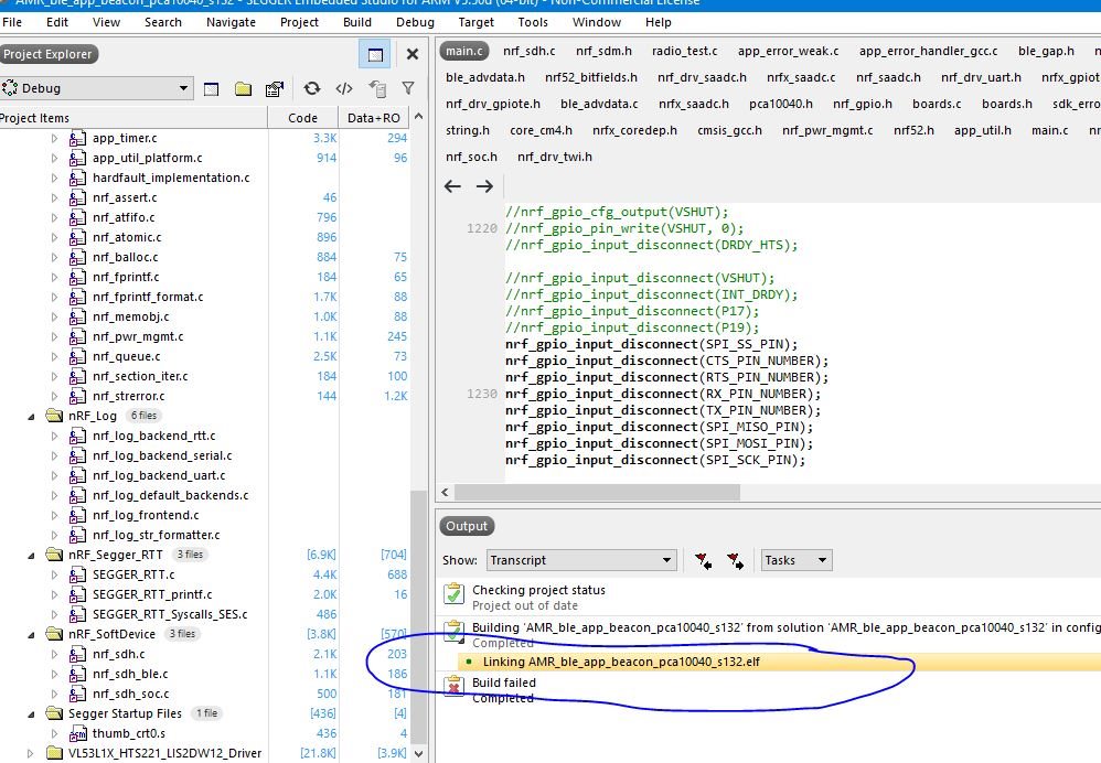

1. all files were successfully attached
2. there is no syntax error, there are only warnings
3. Please help me to resolve this problems as soon as possible.
Is this a configuration issue???
How to solve linking error...
what is means ".elf" file.

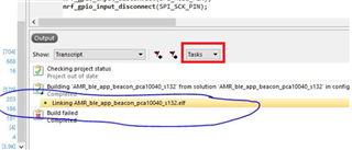

Hi Shubam,
Is it possible to change the 'tasks' in the output window to 'output' and share the messages that appear?
Priyanka
Hi priyanka,
Here's is the messages :
Building ‘AMR_ble_app_beacon_pca10040_s132’ from solution ‘AMR_ble_app_beacon_pca10040_s132’ in configuration ‘Debug’
1> Linking AMR_ble_app_beacon_pca10040_s132.elf
1> C:/Program Files/SEGGER/SEGGER Embedded Studio for ARM 5.50d/gcc/arm-none-eabi/bin/ld: Output/Debug/Obj/AMR_ble_app_beacon_pca10040_s132/VL53L1X_HTS221_LIS2DW12.o:C:\Nordic\nRF5_SDK_15.0.0_a53641a\examples\ble_peripheral\ble_app_beacon+AMR_pulse_count 10_8_21_battery_consuption_21_01_2022\VL53L1X_HTS221_LIS2DW12_Driver/VL53L1X_HTS221_LIS2DW12.c:123: multiple definition of `i'; Output/Debug/Obj/AMR_ble_app_beacon_pca10040_s132/main.o:C:\Nordic\nRF5_SDK_15.0.0_a53641a\examples\ble_peripheral\ble_app_beacon+AMR_pulse_count 10_8_21_battery_consuption_21_01_2022/main.c:134: first defined here
Build failed.
