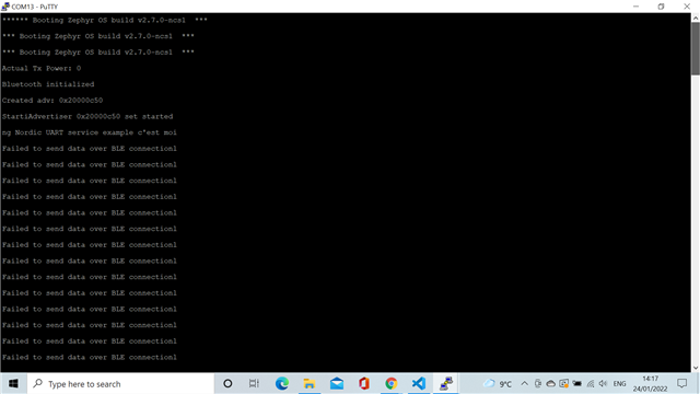

  • Hi Marte,
    I'm setting the tx_power using the function,
    static void set_tx_power(uint8_t handle_type, uint16_t handle, int8_t tx_pwr_lvl)
    Later I'm trying to call this function in my main programme.

    void main(void)
            int8_t tx_power = 0;
    	int blink_status = 0;
    	int err = 0;
    	configure_gpio();
    	err = uart_init();
    	if (err) {
    		error();
    	bt_conn_cb_register(&conn_callbacks);
    	if (IS_ENABLED(CONFIG_BT_NUS_SECURITY_ENABLED)) {
    		bt_conn_auth_cb_register(&conn_auth_callbacks);
    	err = bt_enable(NULL);
    	if (err) {
    		error();
            set_tx_power(BT_HCI_VS_LL_HANDLE_TYPE_ADV,0,tx_power);
    	LOG_INF("Bluetooth initialized");
    	k_sem_give(&ble_init_ok);
    	if (IS_ENABLED(CONFIG_SETTINGS)) {
    		settings_load();
    	err = bt_nus_init(&nus_cb);
    	if (err) {
    		LOG_ERR("Failed to initialize UART service (err: %d)", err);
    		return;
        bt_ready();
    	printk("Starting Nordic UART service example c'est moi\n");
    	for (;;) {
    		dk_set_led(RUN_STATUS_LED, (++blink_status) % 2);
    		k_sleep(K_MSEC(RUN_LED_BLINK_INTERVAL));
    		/*ran_data();*/
    		const uint8_t sensor_data ='d';
    		uint16_t length = 1;
    		//uint32_t sd_ble_gap_rssi_start	( sd, NULL, NULL)
    		//uint8_tsdc_hci_cmd_sp_read_rssi(constsdc_hci_cmd_sp_read_rssi_t*p_params, sdc_hci_cmd_sp_read_rssi_return_t*p_return);
    		if (bt_nus_send(NULL, &sensor_data, length)) {
    			LOG_WRN("Failed to send data over BLE connection");
    			printk("Failed to send data over BLE connectionl\n");

    Irrespective of I change values its always 0. But I wNted to set it the the maximum TX_power of nRF5340 which is 3dB.
     int8_t tx_power = 0x03;
    Karthik Kumar
  • I am using an idential implementation of set_tx_power, and I get the same result. Whenever I request +3 dB I get the Actual tx Power: 0 response.
    I spent some time digging and I suspect the request to set +3dB is reduced to a 0 dB request by a call to hal_radio_tx_power_floor() from deep down in the guts of the bluetooth driver / subsystem
    I can confirm that I am also able to reproduce the issue, but I am still working on finding a solution. It only seems to be an issue on nRF5340 DK, as when trying the same application on a nRF52840 DK the TX power was changed from 0 to 3. Additionally, I tested the HCI Power Control sample in Zephyr, which the set_tx_power() function is originally from, and the TX power is changed successfully on nRF5340 DK using that sample.
    Marte
