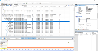

I use nRF5340DK (0.11.0) as HCI controller and noticed it can randomly (?) accept PDUs with access address other than configured. This basically makes it impossible to qualify since there are test cases that test behavior with invalid access address (e.g. LL/ENC/INI/BI-01-C) and there's apparently no way to check the received access address and verify it in sw. I checked known erratas and cannot see anything related. Also the same issue can be reproduced on both Apache NimBLE and Zephyr controllers. Any ideas whether this is just a configuration issue or hardware problem?
