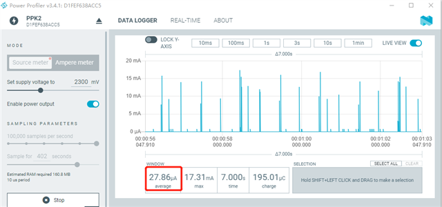

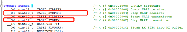

  • Hello, !
    There is no NRF_UART0->TASKS_STOP=1 in SDK_17_1, only NRF_UARTE0->TASKS_STOPTX=1 and NRF_UARTE0->TASKS_STOPRX=1;

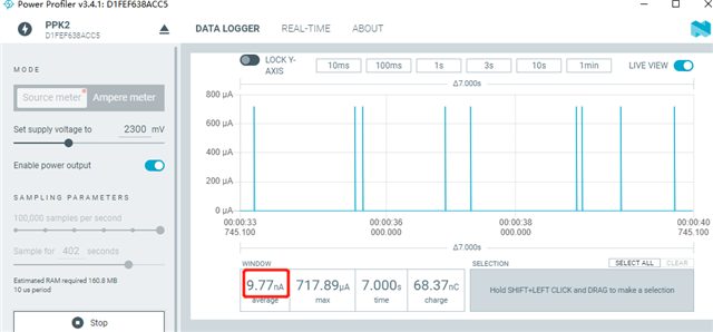

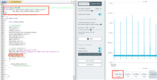

    I performed the following verification(Adopt NRF52832 DK board):
    1、Use Power Profiler's ammeter mode,
    The voltage of DK board measured by multimeter is between 2.7V and 2.8V, and the power consumption is as follows:(1S broadcast once).Serial port shutdown mode, the procedure is as follows:
    1.1、The UART is disabled in idle mode
    1.2、Sleep patterns

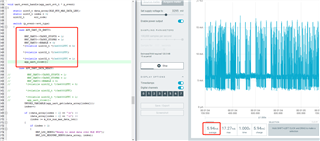

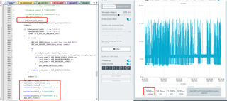

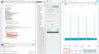

    #if uart_idle
    	void uart_close()
    			NRF_UARTE0->TASKS_STOPTX=1;
    			NRF_UARTE0->ENABLE = 0;
    			app_uart_close();
    ////				*(volatile uint32_t*)(0x40028FFC) =0;
    ////				*(volatile uint32_t*)(0x40028FFC) ;
    ////				*(volatile uint32_t*)(0x40028FFC) =1;
    			*(volatile uint32_t*)(0x40002FFC) =0;
    			*(volatile uint32_t*)(0x40002FFC) ;
    			*(volatile uint32_t*)(0x40002FFC) =1;
    #if  uart_idle_2
    void uart_close(void * p_event_data, uint16_t event_size)
    			//gpio_off();
    			app_uart_close();
    		sd_power_ram_power_set(4,(POWER_RAM_POWER_S1POWER_Off << POWER_RAM_POWER_S0POWER_Pos) |
        (POWER_RAM_POWER_S1POWER_Off << POWER_RAM_POWER_S1POWER_Pos) |
        (POWER_RAM_POWER_S1POWER_Off << POWER_RAM_POWER_S0RETENTION_Pos) |
        (POWER_RAM_POWER_S1POWER_Off << POWER_RAM_POWER_S1RETENTION_Pos));
        static uint8_t index = 0;
        uint32_t       err_code;
        switch (p_event->evt_type)
    			#if uart
    				case APP_UART_TX_EMPTY:
    				#if uart_idle
    					uart_idle_close=1;  //Close the UART
    				#if uart_idle_2
    					app_sched_event_put(NULL, 0, uart_close);

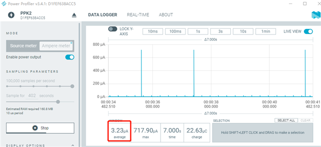

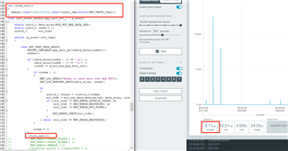

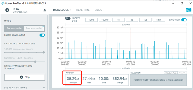

    2、Source Meter mode(Change the voltage to 2.3V)
    2.1  The UART is disabled in idle mode
    2.2 Sleep patterns
    Normal sleep pattern,Idle still has high power consumption,After continuing to reduce the voltage in the variable power supply range, the power consumption is reduced to the acceptable range, and the power consumption continues to decrease, close to the theoretical value, I would like to ask you, what is the power measurement environment in the chip manual? There's some documentation. Maybe I didn't find it.
    Is my test power normal?
    Looking forward to your reply
  • Hi
    Either you can supply power through P21, remove the USB cable, and measure the current in Ampere meter mode, or you can measure power as described by my colleague Stian in this case.
    The conditions under which the nRF52832 was tested is described here.
    Best regards
    Torbjørn
