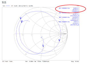

  • Hi Isaac,
    I checked with a colleague that has done direct measurements, and says that 115.771 + 33.357j ohms isn't correct.
    He also said that we can't say anything about the output impedance of the ANT pin, that it doesn't make sense, but what we can say something about is what load impedance is preferred seen into the matching network, and has measured that to be 35 -j46 ohm.
    I can also copy this from a previous case with the same question:
    If you want to design a matching network optimal for max 0 dBm output power, you can get away with just a shunt capacitor and a series inductor. Provided you ground the shunt capacitor like in the reference layout. A 0.8 pF capacitor and 3.9 nH inductor is a good starting point. Measure the impedance seen into the matching network with the radio in TX mode and adjust for 50 ohm.
    The additional components are needed to filter harmonics in 4 and 8 dBm mode.
    The radio front end is identical on the nRF52833 and nRF52840. The reason for the extra inductor in the nRF52833 matching network is to have more margins for the harmonics to the radio regulatory limits in 8 dBm mode.
    Both the -833 and -840 matching networks are ok in 8 dBm mode, it's just that we wanted to attenuate the harmonics a bit more. If you only use 0 and 4 dBm, you can use the -840 matching network on both devices.
    Martin S.
