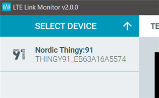

    When connecting the external debug probe to Debug Out (P22) on the nRF9160DK, it will handle the connection automatically. Note that the Thingy:91 must be powered on. To ensure that it is powered, please connect a micro USB cable and switch ON the device. Make sure to use a USB cable that supports data in order for the device to show in LTE Link Monitor.
    You can use the Certificate Manager to update the certificates on your device.
