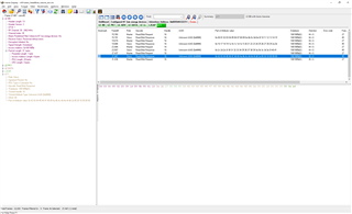

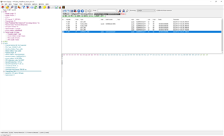

Hi, I send application data using Read blob PDU from nRF52832. nRF52832 firmware is connectivity of  Serialization of nRF5_SDK_17.0.2 for UART interface.
After connection, application data is sent using Read blob response. the Unit of transmission is 22byte for application data.
nRF52832 sent broken data at offset 0x0042. And, nRF52832 could not send application data at offset 0x0058.
Why?

B.R.
    As far as I can see from the log, after the ATT_READ_BLOB_REQ with offset 88, sent from the master, the slave just stopped responding, and the link seem to have been lost. Likely it run into some issue in the application. You would have to debug the nRF52 application to see why it failed.
