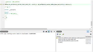

    I'm not sure if I have seen this error before. It's as if the debugger loses connection to the target. I was not able to replicate this here either. I programmed the bootloader, softdevice, buttonless template app and the settings page (with bonds enabled), and then stepped through the ble_dfu_buttonless_async_svci_init() function in main.
    Are you able to reproduce this with the original projects?
  • Yes I reproduced it with the original project as well. What do you think could be the issue then? I have also tried multiple Dev boards here.
    Is there a different BL settings page for bond enabled?
  • Just to confirm, you were able to reproduce this with the original unmodified SDK example as well (i.e. unmodified except for the bond configuration setting)? What SDK version do you use?
  • Hi Vidar. Our custom project was in debug mode, and the bootloader project is always in Release Mode. So both need to be in Release mode.
    Although I don't know why that is necessary. Thanks a lot for all your help and patience :)
