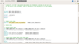

  • Hi Joel,
    Do you have a power/clock interrupt handler in your application defined under a different name? I.e. something else than 'POWER_CLOCK_IRQHandler'
    In our examples, it is redefined to nrfx_power_clock_irq_handler:
    I guess you must have some redefine too that is not included now when you build with -DNRF52833_XXAA.
