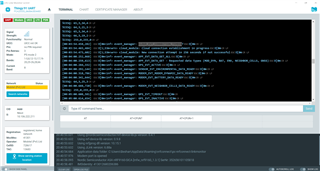

Hello
Using a Thingi91 with latest firmware and Asset Tracker v2. Connects to the tower, but cant seem to connect to the NRF Cloud. How can I check if it can reach any other server (Ping possible? ) ?  What else can I check to see what's wrong. The mobile operator is saying that the sim is enabled for data and has credit. Please help
Log file attached

2022-01-26T15:11:10.691Z DEBUG modem << [00:00:42.408,752] [0m<inf> event_manager: CLOUD_EVT_CONNECTION_TIMEOUT[0m
2022-01-26T15:11:10.693Z DEBUG modem << [00:00:42.415,954] [1;33m<wrn> cloud_module: Cloud connection establishment in progress[0m
2022-01-26T15:11:10.745Z DEBUG modem << [00:00:42.424,072] [1;33m<wrn> cloud_module: New connection attempt in 64 seconds if not successful[0m

2022-01-26T15:12:14.713Z DEBUG modem << [00:01:46.433,471] [0m<inf> event_manager: CLOUD_EVT_CONNECTION_TIMEOUT[0m
2022-01-26T15:12:14.714Z DEBUG modem << [00:01:46.440,673] [1;33m<wrn> cloud_module: Cloud connection establishment in progress[0m
2022-01-26T15:12:14.723Z DEBUG modem << [00:01:46.448,791] [1;33m<wrn> cloud_module: New connection attempt in 128 seconds if not successful[0m

2022-01-26T15:12:28.526Z DEBUG modem << [00:02:00.252,868] [0m<inf> event_manager: APP_EVT_DATA_GET_ALL[0m
2022-01-26T15:12:28.532Z DEBUG modem << [00:02:00.259,643] [0m<inf> event_manager: APP_EVT_DATA_GET - Requested data types (MOD_DYN, BAT, ENV, NEIGHBOR_CELLS, GNSS, MOD_STAT)[0m
2022-01-26T15:12:28.556Z DEBUG modem << [00:02:00.292,785] [0m<inf> event_manager: GPS_EVT_ACTIVE[0m
2022-01-26T15:12:28.566Z DEBUG modem << [00:02:00.298,919] [0m<inf> event_manager: GPS_EVT_AGPS_NEEDED[0m
2022-01-26T15:12:28.581Z DEBUG modem << [00:02:00.306,182] [1;33m<wrn> data_module: Failed to request A-GPS data, error: -13[0m
2022-01-26T15:12:28.583Z DEBUG modem << [00:02:00.313,995] [1;33m<wrn> data_module: This is expected to fail if we are not in a connected state[0m
