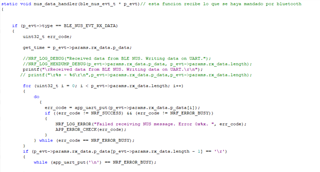

I am using nrf52840 and I want to use nrf_calendar example with app_ble_uart,
I am traying to send parameter from nrf toolbox uart app mobile
but I have no idea how to do that
I tried to manipulate this part code for to set parameter clock ":nrf_cal_set_time(year, month, day, hour, minute, second); " as nrf_calendar example, but I cant
static void nus_data_handler(ble_nus_evt_t * p_evt) {
	if (p_evt->type == BLE_NUS_EVT_RX_DATA) {
		for (uint32_t i = 0; i < p_evt->params.rx_data.length; i++) {
any advice how to get parameter app_ble_uart?

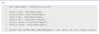

  • Hello Marcos,
    The calendar application gets the time over HW UART (https://github.com/NordicPlayground/nrf5-calendar-example/blob/master/main.c#L176-L181) .
    You can send the time over Nordic URT Service (NUS) in a format you need. Then you have to parse this on the receiving end, and pass the time to nrf_cal_set_time() https://github.com/NordicPlayground/nrf5-calendar-example/blob/master/nrf_calendar.h#L36 . For example, if you want to send time over NUS in this format yyyy,mm,dd,hh,mm,ss.
    Afterwards, you can use a parsing function to get the time, for example strtol () (this function converts string to long integer) or something like that.
    or like this-
    The important thing is that the position of each time parameter is static, so format is important.
    Hope it helps.
    Thanks.

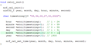

  • Hi Kazi
    thanks for you reply,
    I have a doubt
    Can I change  char timestring[]= "08,54,00,27,00,2022";  to char timestring[]= Varible char;?
    variable char  = NUS data :
    this part handling the data recived over NUS BLE
    I am traying to save data in a variable  get_time = p_evt->params.rx_data.p_data;
     declaration
    I can to print p_evt->params.rx_data.p_data and length also .
    printf("\r%s - %d\r\n",p_evt->params.rx_data.p_data,p_evt->params.rx_data.length);
    and using get_time I am traying to do this
    void reloj_init()
    	nrf_cal_init();
    	uint32_t year, month, day, hour, minute, second;
    	char timestring[]= get_time;
        hour   =atoi(timestring);    // 1 - 24
        minute =atoi(timestring+3);  // 0 - 59
        second =atoi(timestring+6);  // 0 - 59
    		day    =atoi(timestring+9);	 // 1 - 31
    		month  =atoi(timestring+12); // 0 - 11
    		year   =atoi(timestring+15); // 1900
    because I am thinking that the variable get_time = "09,15,00,27,00,2022" ,the data I sent over NUS.
    I guess.. xd
    what is wrong?
    I am beginner  sorry , I have a lot doubts
    best regards
    You may try to create a char array and use the memcpy () function
    (For example // Copies "numBytes" bytes from address "from" to address "to"
    void * memcpy(void *to, const void *from, size_t numBytes);)
    to copy the NUS string to the array.
    Best Regards,
    Kazi Afroza Sultana
  • HI
    yes, you right, I created a char array into nus_data_handler "arr[i]"
    static void nus_data_handler(ble_nus_evt_t * p_evt)// esta funcion recibe lo que se haya mandado por bluetooth
            uint32_t err_code;
                do
    		---->   arr[i] = p_evt->params.rx_data.p_data[i];
    and I used atoi like your example
    void data_update()
    		hour   =atoi(arr+2);    // 1 - 24
            minute =atoi(arr+5);  // 0 - 59
            second =atoi(arr+8);  // 0 - 59
    		day    =atoi(arr+11);	 // 1 - 31
    		month  =atoi(arr+14); // 0 - 11
    		year   =atoi(arr+17); // 1900
    	  memset(arr,0,26);
    now its works , i can to change the time over NUS
