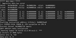

Zigbee Switch results in bootloop
I am using nrf52840-DK and trying to get the Zigbee Switch working.  This is just a plain zigbee switch with no bind to light.  However, this set attribute during init results in the bootloop
SET_ATTRIBUTE
The below code in switch_clusters_attr_init() which causes the issue. Removing this the zigbee device is registered successfully but does not update state
This code is at line 282 in the main.c (also attached here)
 	ZB_ZCL_SET_ATTRIBUTE(
 		ENDPOINT_INVOKED,
 		ZB_ZCL_CLUSTER_ID_ON_OFF,
 		ZB_ZCL_CLUSTER_SERVER_ROLE,
 		ZB_ZCL_ATTR_ON_OFF_ON_OFF_ID,
 		(zb_uint8_t *)&on,
 		ZB_FALSE);
main.c
		HA_SWITCH_ENDPOINT,
		(zb_uint8_t *)&dev_ctx.on_off_attr.on_off,
		ZB_FALSE);

void main(void)
	int err;
	LOG_INF("Starting Zigbee Switch example");
	/* Initialize */
	configure_gpio();
	err = settings_subsys_init();
	if (err) {
		LOG_ERR("settings initialization failed");
	LOG_INF("Registering Device");
	/* Register callback for handling ZCL commands. */
	ZB_ZCL_REGISTER_DEVICE_CB(zcl_device_cb);
	LOG_INF("Setting Switch Context");
	/* Register dimmer switch device context (all the endpoints). */
	ZB_AF_REGISTER_DEVICE_CTX(&switch_ctx);
	switch_clusters_attr_init();
	/* Initialize ZCL scene table */
	// zcl_scenes_init();
	LOG_INF("ZCL scenes initiated");
	/* Settings should be loaded after zcl_scenes_init */
	err = settings_load();
	if (err) {
		LOG_ERR("settings loading failed");
	/* Start Zigbee default thread */
	zigbee_enable();
	LOG_INF("Zigbee Switch example started");
	while (1) {
		// k_sleep(K_MSEC(RUN_LED_BLINK_INTERVAL));
Debug Terminal
