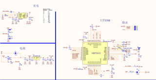

        We are working on a project, using NRF52832, which has the functions of softdevice+bootloader+ble+dfu, the SDK we use is version 17.0.0,
        and RTC2 is used as a 1ms timer. We found that after running for a period of time, 20 devices A device appears in the RTC2 and cannot generate an interrupt.
       Then we deleted the firmware, using the example of the official RTC2 firmware, the interrupt is also unable to enter, we guessed that there is a problem with the internal crystal oscillator.
        How do we solve this problem

  • Sorry for replying to you only now, the custom hardware we use, the ble example doesn't work either, we don't use an external 32k clock, we use an internal 32k clock, so is the internal 32k clock broken?

    If everything is working correctly you should see the LED turn on and off every second (looking at your schematic it seems you are using P0.17 for the LED).

  • Hi ovrebekk
         This situation happened again, and I used your example, 283288_rtc_test, the rtc interrupt is still
    unable to enter, all the rtc can't work, it seems that the internal RC crystal is not working properly. This
    board was working before. I burned the rtc after charging, will the temperature damage the internal RC
    crystal oscillator?
  • Hi Ben
    How do you verify that the interrupt is not entering?
    Are you connecting the debugger, or checking if the LED is toggling?
    What is the supply voltage on the chip after you have charged?
    What about during charging, will the supply voltage change?
    crystal oscillator?
    Do you know how high the temperature could get?
    As shown here the nRF52832 should be fine with temperatures up to 125C when it is not in use.
    Could you send me a closeup picture of your board?
    Best regards
    Torbjørn
