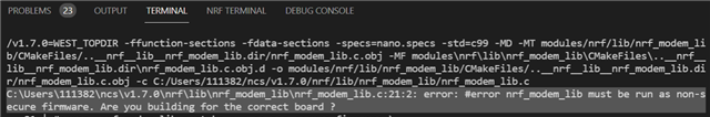

While updating nRF91 modem firmware, found that modem library can be used with non-secure(ns) board only and not with secure board.
On configuring secure board with modem library, it produces an error of "nrf_modem_lib must be run as non-secure firmware". So that have to select non-secure(ns) board for nRF9160.
Image is attached for reference:
In nRF9160, want to use nRF91 secure board with nrf modem library for modem application.
