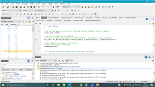

    I have modified the code a bit in order to read 2bytes from register. I am not able to read 16bit registers. I tried to read NPACKCFG_REG but not able to read it properly.As well as while compiling I am getting warnings like this:-
    unsigned conversion from 'int' to 'uint8_t' {aka 'unsigned char'} changes value from '437' to '181' [-Woverflow]
    What do you mean by not being able to read it properly? Are you getting the NRF_DRV_TWI_EVT_DONE event after you have called nrf_drv_twi_rx(), or are you getting a NRF_DRV_TWI_EVT_ADDRESS_NACK or NRF_DRV_TWI_EVT_DATA_NACK event?
    Please show me where you are getting this warning.
  • I am getting warning as shown below:-
    #define NPACKCFG_REG     0x1B5
    when i try to read NPACKCFG_REG some conversion is happening.
    You are only handling the NRF_DRV_TWI_EVT_DONE event in your twi_handler(), and ignoring NRF_DRV_TWI_EVT_ADDRESS_NACK and NRF_DRV_TWI_EVT_DATA_NACK. Please add these events to your handler and see if either of these are triggered.
    Your screenshot does not show the source file from where you are getting the "unsigned conversion from 'int' to 'uint8_t' {aka 'unsigned char'} changes value from '437' to '181' [-Woverflow]" warning from.
