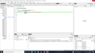

Hi, I need to use UART0, UART1 and I2C0 in my application. I initialized these in overlay file (attached). When, debug is run, it is observed that the I2C binding is not successful see attached image file. I am using UART0 and UART1 in asynchrounous mode.  The zypher.dts fie also is attached.

  • Yes, I tried to initializae the I2C0 peripheral using
    void init_i2c_master()
    dev_i2c = device_get_binding("I2C_0");
    if (dev_i2c == NULL) {
    printk("Failed to get I2C0 binding\n");
    return;
    after disable of UART1 using
    void disable_uart1(){
    NRF_UARTE0->TASKS_STOPTX = 1;
    NRF_UARTE0->TASKS_STOPRX = 1;
    but, I2C initilaize fail, when run Debug .. though build and Compile is successful.
  • Hello, I tried after adding the configurations in prj.conf, but I2C0 binding is not successful.
    Please, test the following Code:
    //************ Add to prj.conf file ******
    CONFIG_SERIAL=y
    CONFIG_UART_ASYNC_API=y
    CONFIG_RESET_ON_FATAL_ERROR=n
    CONFIG_LOG=y
    CONFIG_THREAD_NAME=y
    //***************add to the overlay file
    &uart0{
        current-speed = <115200>;
    &uart1{
    current-speed = <9600>;
    status = "okay";
    &i2c0{
      status = "okay";
      clock-frequency = < 400 >;
    static const struct device *wifi_uart;
    static const struct device *bms_uart;
    		return;
    void wifi_uart_init(void)
    	wifi_uart = device_get_binding("UART_0");
    	if (wifi_uart == NULL) {
    		printk("Failed to get UART0 binding\n");
    		return;
    void bms_uart_init(void)
    	bms_uart = device_get_binding("UART_1");
    	if (bms_uart == NULL) {
    		printk("Failed to get UART1 binding\n");
    		return;
    void enable_uart1(){
            NRF_UARTE0->TASKS_STARTRX = 1;
            NRF_UARTE3->TASKS_STARTRX = 1;
    void main()
    	wifi_uart_init();
    	bms_uart_init();
            disable_uart1();// disable UART1 to enable I2C0
            init_i2c_master();// I2C0 enable
