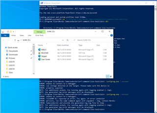

  • Hello Elfving,
    Here are the results of --recover and --reset. The board are not responding at all to the nrfjprog command. Any command gives the same response.
    PS C:\Program Files\Nordic Semiconductor\nrf-command-line-tools\bin> .\nrfjprog.exe --recover
    ERROR: No debuggers were discovered.
    NOTE: For additional output, try running again with logging enabled (--log).
    NOTE: Any generated log error messages will be displayed.
    PS C:\Program Files\Nordic Semiconductor\nrf-command-line-tools\bin> .\nrfjprog.exe --reset
    I am also not able to run with --log as seen below:
    PS C:\Program Files\Nordic Semiconductor\nrf-command-line-tools\bin> .\nrfjprog.exe --reset --log
    WARNING: Logging is unavailable. nrfjprog.exe does not have write
    WARNING: permission for the log file
