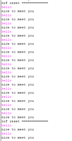

I have some customize that is when nRF received data from computer, it will send any data I want back to the computer.
Eg: my computer send "hello" and nrf after receive"hello" it will send to back "nice to meet you".

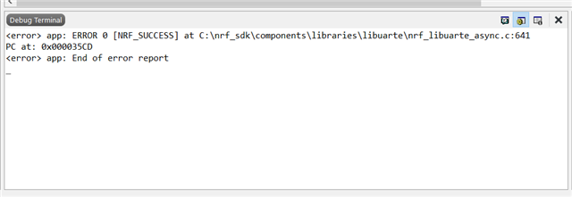

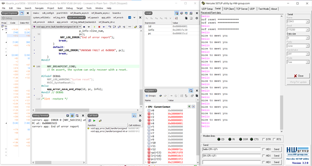

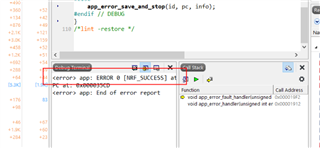

But after I send some line "hello" from my computer and receive"nice to meet you" => nRF reset. I think TX (save in somewhere I don't know overflowed)

here is my code just edit line 37 into 38. But my code not work smoothy like the example. Please give me some hints. I really appreciate about that.
