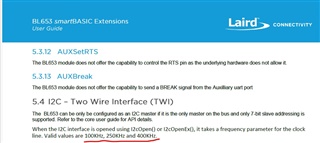

    when we enable this frequency on our logic analyzer we are able to read 413Khz as attached in screenshot, we are using laird bl653 (document attached - CS-GUIDE-BL653-DVK_v1_0-1855868.pdf)
    we need to know the tolerance of acceptance ? is 413Khz acceptable ?

    as per above configurations & mentioned detail here https://docs.zephyrproject.org/latest/reference/peripherals/i2c.html, we don't have 250Khz config
    and attached in laird bl653 document (CS-GUIDE-smartBASICEXT-BL653 v30_2_2_0_0.pdf) it mentions 250Khz (document and screenshot attached)
    we want to have more clarity about speed configurations in I2C

    Zephyr for this board (BL653) suggests using the I2C driver. while for nordic chips, in the same document there is a reference to the use of TWI, when setting which you can explicitly specify the exchange rate in Hz (see here nrf-twim with zephyr).

    As mentioned, 413kHz should be fine as it's just a slight variation. And regarding the i2c speeds, since the BL653 has the nRF52833, you should be able to use the 250kHz speed, as mentioned, in nrf-twim.
