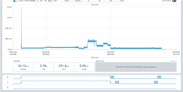

The screenshot action results in a chopped image. See the top part is missing?

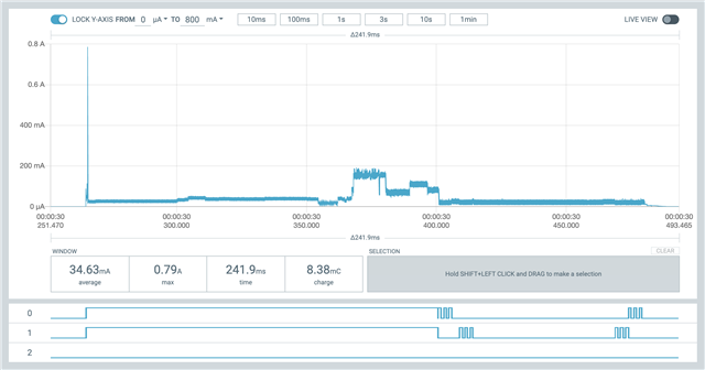

A screenshot looks so much better:
Looking at git blame I see the screenshot code is 'old' and never changed after it was added. Maybe this chopping code made sense in a different app, but not in the power profiler?
