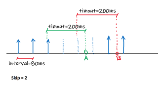

    To clarify it, let's assume a periodic event which is 80ms, timeout is set to 200ms and skip=2, take a loot at below image.
    Now if three consecutive events are lost (for any reason are not received by the receiver), then does it timeout at point A (200ms after the last received packet), or it first skip 2 expected events and then timeout timer expires at point B which is then will not be terminated (a packet is received before timeout)?

    The timeout should then be at point A, which is timeout (200 ms) after the last correctly received packet.
    Further, the device should listen for the advertising event at the starting point of the sketched timeout leading to point B, since waiting longer would mean waiting longer than the timeout.
    Note that using the interval and timeout from your example, the effective skip setting would be 1 for all skip values 1 or higher, since at most 1 advertising event could be skipped without overstaying the timeout.
    Note also that the advertiser itself should send advertisements on all advertising events.
