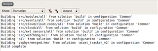

Sample application for Nordic Thingy 91 low power consumption.
Is there a low power consumption for battery powered long term (months) application for Nordic Thingy 91?
I don´t need GPS position, just to receive sensor data and button press reports.
Regards
  • iarakis said:
    I know about asset tracker V2, but I would like the low power version. I get an error when compiling with Segger SES.
    We do not have a pre-compiled low-power version. Could you please provide me with the full transcript output of your build?
    Markus

    Build failed
  • I’m not able to reproduce the error you are getting myself, so we might need to check your toolchain. Could you please build the application on the command line, as described here, and share the complete build log?
  • Look, I did with the command line. It almost compiles completely, but in the end it crashes with the same error.

    [60/294] Building C object CMakeFiles/app.dir/src/modules/led_module.c.obj
    FAILED: CMakeFiles/app.dir/src/modules/led_module.c.obj
    C:\Users\103163\ncs\v1.7.0\toolchain\opt\bin\arm-none-eabi-gcc.exe -DAPP_VERSION=v1.7.0 -DBUILD_VERSION=v2.6.99-ncs1 -DKERNEL -DNRF9160_XXAA -DUSE_PARTITION_MANAGER=1 -D_FORTIFY_SOURCE=2 -D__LINUX_ERRNO_EXTENSIONS__ -D__PROGRAM_START -D__ZEPHYR__=1 -I../src -I../boards/thingy91_nrf9160 -I../src/modules/. -I../src/cloud/. -I../src/cloud/cloud_codec/. -I../src/ext_sensors/. -I../src/watchdog/. -IC:/Users/103163/ncs/v1.7.0/zephyr/include -Izephyr/include/generated -IC:/Users/103163/ncs/v1.7.0/zephyr/soc/arm/nordic_nrf/nrf91 -IC:/Users/103163/ncs/v1.7.0/zephyr/lib/libc/newlib/include -IC:/Users/103163/ncs/v1.7.0/zephyr/subsys/net/lib/sockets/. -IC:/Users/103163/ncs/v1.7.0/zephyr/subsys/settings/include -IC:/Users/103163/ncs/v1.7.0/nrf/include -IC:/Users/103163/ncs/v1.7.0/nrf/lib/at_notif/. -IC:/Users/103163/ncs/v1.7.0/nrf/lib/at_cmd_parser/include -IC:/Users/103163/ncs/v1.7.0/nrf/subsys/net/lib/nrf_cloud/./include -IC:/Users/103163/ncs/v1.7.0/nrf/subsys/event_manager/. -IC:/Users/103163/ncs/v1.7.0/modules/lib/cjson -IC:/Users/103163/ncs/v1.7.0/nrf/modules/cjson/include -IC:/Users/103163/ncs/v1.7.0/modules/hal/cmsis/CMSIS/Core/Include -IC:/Users/103163/ncs/v1.7.0/modules/hal/nordic/nrfx -IC:/Users/103163/ncs/v1.7.0/modules/hal/nordic/nrfx/drivers/include -IC:/Users/103163/ncs/v1.7.0/modules/hal/nordic/nrfx/mdk -IC:/Users/103163/ncs/v1.7.0/zephyr/modules/hal_nordic/nrfx/. -IC:/Users/103163/ncs/v1.7.0/nrfxlib/nrf_modem/include -isystem C:/Users/103163/ncs/v1.7.0/nrfxlib/crypto/nrf_cc310_platform/include -Os -imacros C:/Users/103163/ncs/v1.7.0/nrf/applications/asset_tracker_v2/build/zephyr/include/generated/autoconf.h -ffreestanding -fno-common -g -gdwarf-4 -fdiagnostics-color=always -mcpu=cortex-m33 -mthumb -mabi=aapcs -mfpu=fpv5-sp-d16 -mfloat-abi=hard -imacros C:/Users/103163/ncs/v1.7.0/zephyr/include/toolchain/zephyr_stdint.h -Wall -Wformat -Wformat-security -Wno-format-zero-length -Wno-main -Wno-pointer-sign -Wpointer-arith -Wexpansion-to-defined -Wno-address-of-packed-member -Wno-unused-but-set-variable -Werror=implicit-int -fno-asynchronous-unwind-tables -fno-pie -fno-pic -fno-strict-overflow -fno-reorder-functions -fno-defer-pop -fmacro-prefix-map=C:/Users/103163/ncs/v1.7.0/nrf/applications/asset_tracker_v2=CMAKE_SOURCE_DIR -fmacro-prefix-map=C:/Users/103163/ncs/v1.7.0/zephyr=ZEPHYR_BASE -fmacro-prefix-map=C:/Users/103163/ncs/v1.7.0=WEST_TOPDIR -ffunction-sections -fdata-sections -specs=nano.specs -std=c99 -MD -MT CMakeFiles/app.dir/src/modules/led_module.c.obj -MF CMakeFiles\app.dir\src\modules\led_module.c.obj.d -o CMakeFiles/app.dir/src/modules/led_module.c.obj -c ../src/modules/led_module.c
    In file included from <command-line>:
    C:/Users/103163/ncs/v1.7.0/nrf/applications/asset_tracker_v2/build/zephyr/include/generated/autoconf.h:63:35: fatal error: led_state_def.h: No such file or directory
       63 | #define CONFIG_LED_STATE_DEF_PATH "led_state_def.h"
    compilation terminated.
    [72/294] Building C object CMakeFiles/app.dir/src/events/led_state_event.c.obj
    FATAL ERROR: command exited with status 1: 'C:\Users\103163\ncs\v1.7.0\toolchain\opt\bin\cmake.EXE' --build 'C:\Users\103163\ncs\v1.7.0\nrf\applications\asset_tracker_v2\build'
  • Thanks, Ivan! You need to build the Asset Tracker v2 for the thingy91_nrf9160_ns, as the secure version is not supported.
    Markus
