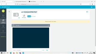

Is there a low power consumption for battery powered long term (months) application for Nordic Thingy 91?
I don´t need GPS position, just to receive sensor data and button press reports.
Regards
Hello Ivan,
as also mentioned in the Nowi block, the recommended application to use as a starting point is the Asset Tracker v2. You can build it adding a low-power overlay file for reduced current consumption.
Markus
Hello Ivan,
iarakis said:I am not managing to compile, that is why I am asking for a precompiled file. Regards
You can find a pre-compiled Asset Tracker v2 application in the download section for the Thingy:91.
Markus
