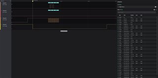

My issue is regarding reading the MISO line however, for the sake of simplicity I typically trial SPI on an ADXL345 or a SPI ADC by another vendor. Unfortunately, while I can send the data via MOSI, shown in the logic analyzer breakdown, MISO only responds with 0x00.
0x2D Send0xC0 Send

The code basically takes the simple example from here and creates a write function with an address and value argument pair. My expectation is that if I send 0xC0 and then a dummy value, 0xFF, that it should return 0xE5, the device ID built in as shown in the datasheet on page 23. 0xC0 due to the first two bits needed for read and multi-byte (datasheet page 16), although even leaving it as (0x00 | 0x80) I had no luck either.
The 0x2D value is another pair to make sure the device is reset.

  • Hello Simonr,
    The write_test function uses spi_test_send() which calls spi_transceive(spi_dev, &spi_cfg, &tx, &rx).
    If I write 0xC0 followed by dummy data shouldn't that mean that I've accessed the register 0x00 for reading? 0x00 | 0x80 | 0x40 (0x80 for read and 0x40 for multibyte mode).
    Isn't spi_transceive mean't to send values and receive values back simultaneously from the slave device? So if I write as above I expect there to be a returned value on the MISO line (0xE5 is the value, deviceid of the adxl345).

  • Hi
    Agreed, sorry I didn't read into the spi_test_send() function closely enough. You should indeed see something return on the MISO pin. Can you double check that your SPI device is connected to the correct pins and that it is correctly powered, and so on. I can't see a reason in your code that you shouldn't get any data in return, so my initial thought would be that the SPI device is not working as expected.
