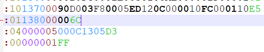

I am using nordic52840 development kit board. and I am using sdk17.1 for development.
I tried to create .bin for secure bootloader code inside DFU. but the file size is very large. for my case its around 261MB.
Can any one help me here that why i am getting this much size for binary.
For hex its only 141KB.
Regards
Rohit Saini
  • And also if i create zip package from hex file then it will automatically remove the UICR register form the hex file and create the binary file from it. and the size of that bin file is exact the same what i required.
