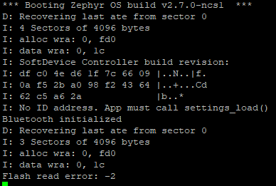

After stepping through the code it seems as "nvs_init()" is called twice, once by "bt_enable()" and again within my custom initialization of nvs. I have attached a screenshot of the UART output and what's interesting is that both instances of nvs return the same "alloc wra" and "data wra" values. Is this expected?

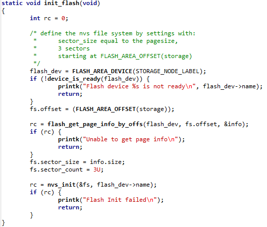

Here is my custom initialization of NVS below:
Are there additional settings that need to be modified when using Bluetooth with NVS for user data?
