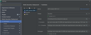

I'm trying to reload CMake in an nRF-Connect-SDK project in the CLion IDE. I've been using this guide:
https://blog.jetbrains.com/clion/2021/04/using-nrf52-with-cmake-connect-sdk/
My current toolchain and CMake settings are like these (the SDK version is 1.6.1):
The project starts reloading, it detects zephyr, west, etc., the build directory is created, but eventually it stumbles upon this error:
CMake File API: D:\Programming\Embedded\Projects\SES\ncs\custom_project\custom_project\build_clion: no reply dir found
I can see that in D:\Programming\Embedded\Projects\SES\ncs\custom_project\custom_project\build_clion\.cmake\api\v1 there is only "query" directory, but no "reply".
"query" directory contains these empty files:
I'll list the CMake output from the stage where it fails here:
