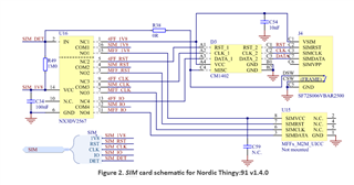

I need to know in which case the SIW_DET pin is used. Does it depend on the version of the nRF9160 ? Then which versions ?
And is this detection function better in software or hardware ?

according to the Pin assignments of the nRF9160 Product Specification, SIM_DET is not used and needs to be left floating.

The problem is that on the thingy91 this pin is connected to the sim holder which have a switch mounted. It can be disconnected by removing an R0 but I don't undstand why the design would be made this way if the SIM_DET is not in use in every versions of the nRF9160.

I’m not a hardware expert, but to me it looks like that SIM_DET is not connected neither on the Thingy:91, see picture below.

Can you tell me what version it is ? Mine is the 1.4.0 and the SIM_DET is connected :

Good point, Jean! This was changed in the latest version of the Thingy:91, v1.6.0.
