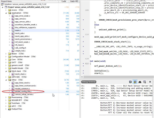

The problem occurs when I add the necessary header files within a folder I created. Keep in mind, I add the header files in the preprocessor to avoid any issues.
Initially, by adding the header files, you don't get an issue. Building the code - no errors. Flashing onto the device - mesh initiates properly. However, to re-create the issue:
1) add generic_onoff_server.c and generic_onoff_mc.c onto folder within sensor server.
2) Add any #define on main.c or any integer types.

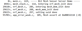

After this, building it shouldn't cause any issue. Only after flashing the firmware onto the device, does the device become undiscoverable and show the error shown below.

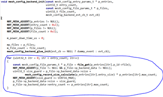

When debugging line by line, it fails at mesh_config_backend_init() inside mesh_config_backend.c at the for loop (line 102) shown below.
