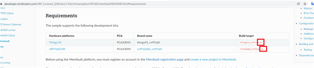

Memfault sample does not compile with SDK v1.8.0
  • NRFConnect SDK 1.8.0
  • arm-none-eabi-gcc (GNU Arm Embedded Toolchain 10.3-2021.07) 10.3.1 20210621 (release)
  • Ubuntu 20.04
When copying the sample nrf/samples/nrf9160/memfault and running the build command west build -b thingy91_nrf9160 -p I first get the error that the firmware has to be build as non-secure as described in the documentation. After enabling/setting the KConfig options
  •  CONFIG_TRUSTED_EXECUTION_NONSECURE
  • CONFIG_MEMFAULT_NCS_PROJECT_KEY
  • CONFIG_MEMFAULT_NCS_DEVICE_ID
  • CONFIG_MEMFAULT_NCS_FW_TYPE
the code compiles spm_subimage and mcuboot_subimage but then fails in the next step (main app image I presume) with static assertions:
NRFConnectSDK/zephyr/soc/arm/nordic_nrf/validate_base_addresses.c:82:26: error: 'NRF_CRYPTOCELL' undeclared here (not in a function); did you mean 'NRF_CRYPTOCELL_S'?
   82 | CHECK_DT_REG(cryptocell, NRF_CRYPTOCELL);
and a few other checks in this file.

  • Please add the nonsecure extension (_ns) after the board option, to build it as nonsecure. After setting up the the project key (see Minimal setup) I was able to build the sample nrf/samples/nrf9160/memfault (NCS v1.8.0) by using the following command:
    west build -b thingy91_nrf9160_ns -d build_thingy91
    If you look at the documentation, you can see that only the nonsecure boards are supported:
    Simon
